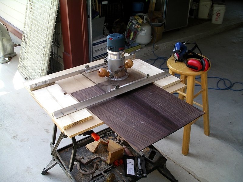

I made a sled for my router that I use for thicknessing sides, backs and soundboards. I got the idea from a post Colin made about 6 months ago. It works pretty well. Craig Holden has a jig that does the same thing with the added feature of holding the wood down with a vacuum.
I use this thing to get within about 0.01" of my target thickness then finish up with a RO sander.

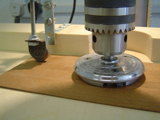

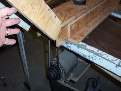

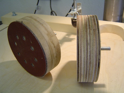

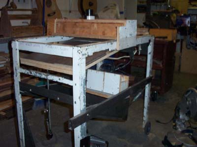

For thicknessing, i use my home made drum sander, i looked around from google searches and it brought me many places where i picked up ideas to come up with my design, not so hard to make.

The sled is pretty simple. The base is a piece of 1/2" MDF about 20X30" (big enough to place a joined back or top on it)and a couple of 3/4" plywood scraps. The rails are two 1" aluminum angles from Home Despot.
For the sled part, I got a piece of acrylic from the local Woodcraft store to mount the router on. They sell them as router baseplates. I cut a couple of 6" pieces of the aluminum angle and bolted that onto opposite edges of the acrylic piece. The rollers are bolted to the angle pieces and ride on the rails. I found the rollers in the screen door / sliding door repair aisle at Lowes. Home Depot had some plastic ones, but Lowes had metal-with-bearings and I thought those would be smoother rolling.
My router came with a detachable base which I bolted to the sled. Total cost of materials for the whole thing was less than $30. I will probably add some hold-downs in the future to help hold the wood flat to the base.
There are two downsides I experience when using this thing. The first is that I don't have dust collection on it, so I have to use it outside. The second is that when using a straight router bit, the bit leaves tool marks on the wood. I'm going to try a 1/2" downcut bit to see if I get a cleaner cut. As it is, I use this thing to get to within ~0.01" of my final thickness then switch to my RO sander and scraper to remove the last bit of wood along with the tool marks.
